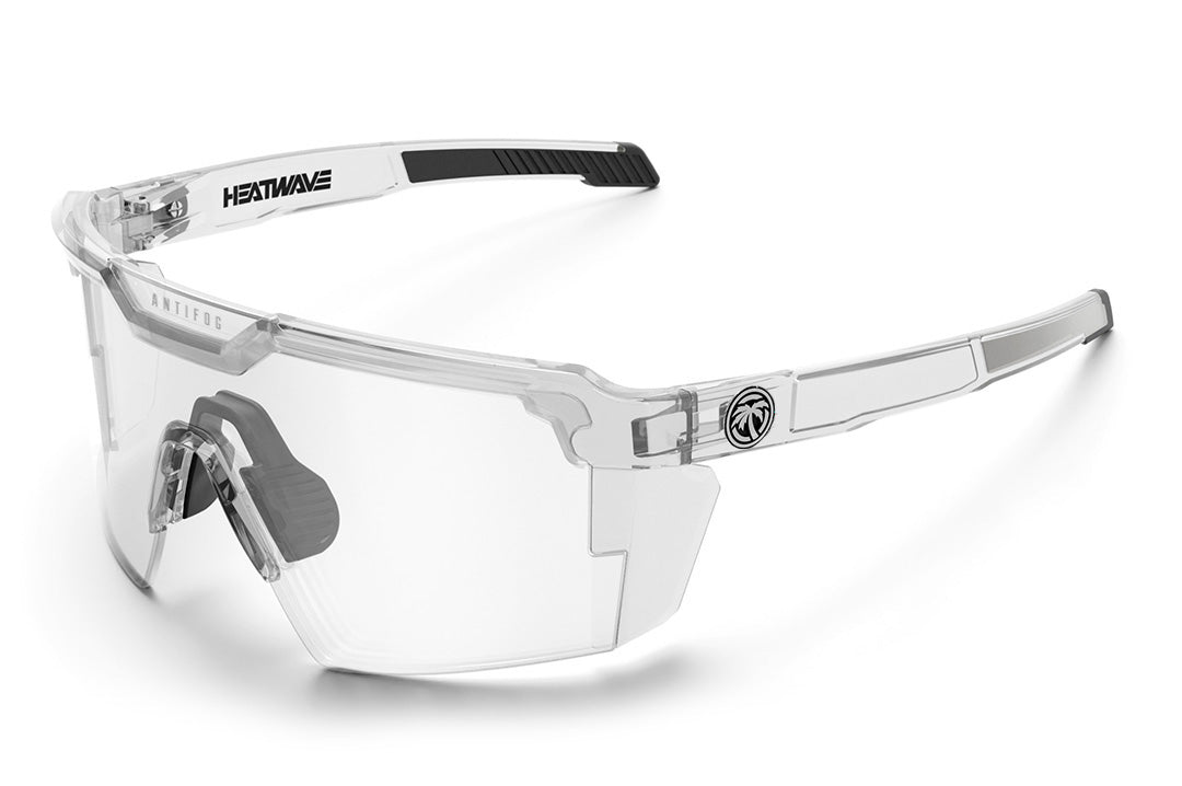

If you wear safety glasses then don't turn anything to big or risky because glasses will protect your eyes but not your whole face. A piece could still hurt you even if your eyes are protected.
PS:If you guys want a good pair I absolutely love these....

Thank you so much for all your recommendations. I mostly do spindle and small boxes , my lathe it’s small it’s a Rikon 70-150 VSR never tried a bowl or a base. But I’ll try to be more careful.
