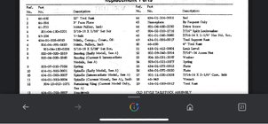

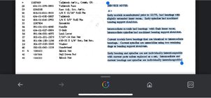

There is a difference between post and pre-1972 headstock bearings for the old Delta 46-111. Does anyone know where I can buy the SP-5339 equivalent bearings? I picked up a 1969 generation unit to dedicate to my Beall buffing system.
I found this information at Mikes Tool online. It mentions that I need the “extended-race” version of the bearing which was used on the earlier machine like mines rather than the post 1975 non-extended race. Is the 87505 an extended race version?
The extended race bearings Delta-Rockwell used were usually New Departure. New Departure was owned or partnered with Rockwell-Delta so no surprise they used their bearings.
Be aware the OWWM site has a recommended source of replacement bearings. I found their source to be a total rip off and the sales lady is rude too. Motion Industries is my go-to source for bearings. They have 450 outlets nationwide and will do stock transfers to your local branch free of charge.
Sometimes you can get away with a spacer to account for the extended race. But that depends on the ability to make an accurate thickness spacer. If the application has adjustable bearing pre-load thickness is not an issue.
Is it correct that I should look for 87505 bearings that are Sealed and Permanently lubricated? Does a rubber seal on the extended race side and metal shielding on the other side yield permanent lubrication or do I need metal on both sides?
Rubber seal on both sides is best. Shielded will allow grease out/contaminants in, though inside a HS is not a tough environment - shielded is ok if that’s what you can get.
The detail most often overlooked when people think they can do this^^, is the fact that the non-extended side of an 875xx-series bearing isn't flush...it's recessed - a lot of folks don't realize this. It's best to use bearings consistent with the original design.
