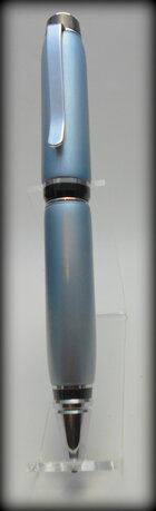

I've done a few anodized pens on the wood lathe. The process is complex and results vary. I used a variable supply as you need to adjust it as you are setting up. Cleanliness is everything!
First Anodised Cigar 7-5-16.JPG Brad Gothard has some excellent YouTube's on the process.
If you DM me, I can send you his PDF "How to Anodize at Home"
