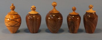

Here are 5 Keepsake Urns that I applied the 4th heavy coat of lacquer yesterday morning ( the lids were finished with CA and yes they could have used some more coats).
Don that is a great representation of a very good lacquer finish (like I have used for over 20 years), but if I could put one of Steve's finished pieces in your mix you would definitely see a difference. As I have been getting ready for the fall shows I have not had the time to actually use Steve's finishing setup so I'm still using lacquer, but all I need for the process is now on hand to start when my shows are done. I do not know if it will be cost effective for the stuff I sell at these shows and what I get for them to use Steve's process but I know that on my really high priced pieces that finish will help. I don't think I will ever stop using lacquer as there isn't a quicker glossy finish to be found.
