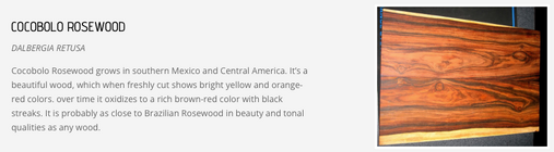

I have a variety of cocobolo wood and that piece is possible but doesn't look enough like it. But wood can be highly variable and difficult to tell from such a photo of side grain. Most of my cocobolo, but not all, has more color (orange, red, yellow etc). What I have was evidently cut from big trees and has no sapwood so I have to reference there. I've never seen any from a branch that tiny. Does that piece have sealer on it biasing the color?
But for me the most distinctive quick identifier is the smell. Smell it once and you can't forget. Saw a bit o the bandsaw, sand or turn some. As the wood database mentions, the scent is a bit spicy, sweet - I like the scent.
Also, be careful, many people are quite sensitive to cocobolo - a bit of sawdust under a bandaid on the forearm is a good non-fatal rash test. We knew a guy who was so sensitive he refused to enter a classroom and use a lathe that cocobolo had been turned on.
But the best way to ID cocobolo (and many species) is to shave a spot on the endgrain of a small sample with a single-edged razor blade and look at it with a 10x magnifier (I use a low-power stereo microscope). The picture at the bottom of the page on the Wood Database article doesn't do it justice - what I always see is the pores packed with clear, hard, orangish resin. In my experience, if the heartwood pores are not filled with this resin it's not cocobolo, at least not mature cocobolo. (Section 7 of their article on wood identification gives the procedure to prepare and examine the end grain) Just a very small sample is needed. I usually cut a piece that shows about 1/2"x1/2" endgrain, at least several rings, long enough to hold onto easily (or glue it to a small flat stick)
A read of the Wood Database ID article is often helpful:
Some of the end grain photos on the hobbithouseinc.com article are better but still not anything like seeing it with the eye in good light. However, the HobbitHouseInc is also the best resource I know of to show the INCREDIBLE variety in color, figure, face and side grain any species, both heartwood and sapwood, unfinished and finished, boards, turnings. I often suggest that website to impart a feel for how much variety can be in wood even from various trees of the same species.

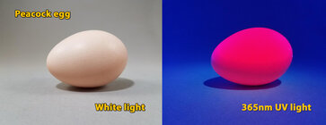

Some other interesting things to do with a UV light:
Walk through the woods at night and see how many Kentucky flat millipede are near. Around here I almost always see a bunch within 10' of anywhere. The orange bands fluoresce bright green.
Look for fungi, many fluoresce.
Find lost things. I've also used a powerful UV light to find things I've dropped in fields and woods. (I like to wrap a strip of orange gaffers tape around small things I tend to misplace in the daytime - the tape glows brightly at night with UV!
Find eggs: Once a nighttime walks I noticed a bright red light from under some bushes. It turned out to be a nest of guinea eggs. Guineas are notoriously secretive about where they create their nests.
Some experimentation revealed that brown eggs of all types (guinea, peafowl, chicken) fluoresce bright red but the red slowly fades with time. I suspect it's a coating on the egg which oxidizes or fades with moisture but I haven't done a careful experiment.
The usefulness to me is when I find a nest I usually rob some of the eggs to incubate but leave a few so the bird will continue to lay. (They can't count) I pick up the brightest red eggs and leave the older ones. The freshest are more likely to hatch healthy chicks. (I sometimes also leave a few turned wooden guinea eggs as decoys.)
An example of the fluorescence with a freshly laid peafowl egg:
OK, this is a test of how far off topic I can get without getting ejected from the forum! :)
