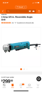

I had a WTW angle drill that died an earlier death than expected, I also found it a little uncomfortable to use. I have since gone to a regular drill for the inside of bowls and a Makita DA3010F right angle drill (which is a true 90 degree angle drill) for the outside. The Makita was expensive but is so much more comfortable to use I would have trouble going back to anything else.
