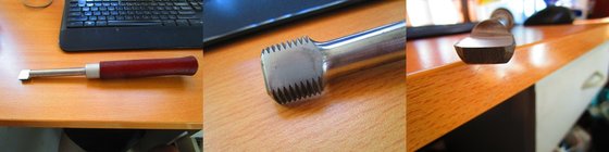

I use this, its a 3 in 1 type with 17 tpi, double sided, does both internal and external, hollow ground, front edge is sharp for any final clean ups.

Hughie, is that a regular bottom tap with 2 sides ground off?
Mike
No , its screw cut 20mm dia 17tpi made out of 1040 steel hardened and tempered, hollow ground and works just fine. I would have used HSS but really dont have any way to heat-treat it.
Plus I didnt like the idea of having multiple tools for the same task ,I suppose it makes sense if you're selling tools. But for me it was an added expense and not necessary. I have made a few for others since this and it has proved to be a good tool. I am putting all these sort of ideas in a e-book or similar, hopefully it will be found useful in the woody community.
