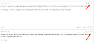

Why is there a need to sharpen the gullet? All the cutting is done at the very tip of the tooth.
Richard, I am not sure about that one. When you sharpen your chainsaw, you sharpen the gullet don't you? I do figure that the tip of the tooth, which is at the top of the gullet does the action.

I dont really sharpen the gullet per se. I start in tge gullet an pull the but down and forward. This cuts the borrom of the tooth but can shorten the tip. If you run the blade backwards with a diamond hone it levels the top and sharpens that side.
I don't see a post from a "Richard" in this thread (unless I overlooked it) so I can't find the original message. What was the comment?

Message #22.

Message #22.

Unless I'm supposed to feel special, it happens to everyone if there is no message #22 in the thread. ...#19, #20, #21, #23..., etc.
I think a message number can disappear if a message is deleted.

Hmmm, well, here's what post #22 looks like right now on my phone.
