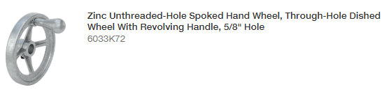

Kipp makes what you have in some version of plastic, cast zinc, and all steel. I went all steel, it's gonna last forever. I bought direct from Kipp USA. I'm not sure if McMaster Carr is selling this brand (probably), but I also don't know if they sell all three handle materials.
