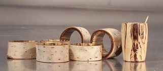

A small lidded box would be nice especially if the Birch wood is spalted, turning Birch with the bark on is difficult, the wood will shrink and the Birch bark does not, and then the bark likes to unroll like paper from the wood, CA can stop that, but the bark will still be loose.
Here is box from spalted Birch and some napkin rings of Birch.
