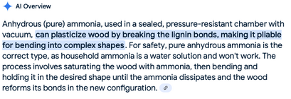

I assumed he meant anhydrous ammonia. In a vacuum chamber, anhydrous ammonia will allow extreme bending of wood.
