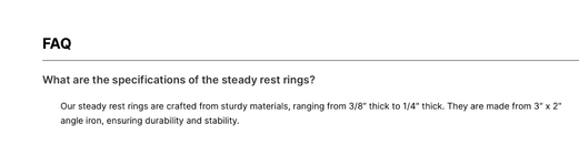

From his website...
What are the specifications of the steady rest rings?
Our steady rest rings are crafted from steel, either 3/8″ thick or 1/4″ thick. They are made from 3″ x 2″ angle iron, ensuring durability and stability. All bases are wrap around design to provide an additional bolt against the lathe body for additional support. Alignment and Attachment Plates for your lathe are included.
