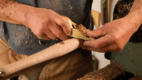

Block plane on lathe.
That is a very old method and of course as John said it works best on spindle turning straight areas and works great removing high spots by bridging over the low spots.
Any one else use this technique on spindles etc on the lathe?
Since I'm more a spindle turner than bowl, I use that technique fairly often. Its easier to make a straight segment on a spindle with the block plane, than with a skew, since the body of the plane helps a lot with that. I turn the lathe speed way down, and set the blade very shallow, after turning it close to finished size.
Well, I don't turn many spindles. If I was to use a small block plane, I would use it at a skewed angle rather than straight on like shown in the video. If nothing else, you wouldn't have the dig in marks from the edges of the plane blade. Even with my limited skew skills, I get a better surface with it than with the block plane. Some times I get a better surface with a peeling cut than I do with the standard skewed bevel rubbing cut. Yes, I do need more practice.
Is that the Fine Woodworking video referred to at the beginning of this thread?
When ever I click on it, it comes up and then goes blank so I am assuming that a fee is involved, which I didn't choose to pursue, so if they are not presenting the plane at a skew angle then Fine Woodworking has gone down to the subbasement of quality content.
It's a Mario Rodriguez video through FWW. I agree the technique has limited usefulness and maybe none for bowl turners, but it was an interesting video and I wouldn't question the viability of a technique presented by Mario Rodriguez; only how useful it is for what I do. It may or may not be accessible free on FWW's website. I subscribe and got access through an email previewing an issue of FWW, so it might not be available to non-subscribers.
