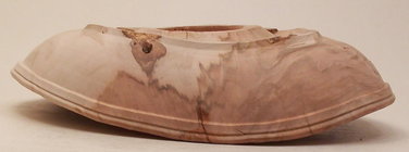

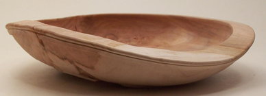

Here is another reason foe some warping, this is once turned Apple wood, where the center part is dark hearth wood and a wide area of sapwood, the sapwood is shrinking while the long grain heart wood is not, and so the sapwood side pulls the bowl into the shape you see.
