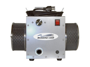

Anyone have one like this?
I have used a similar unit for painting. It works well, you want it in a different room. I have it plumbed through a wall. With that said, you are tethered to the base unit by a hose. I haven't used it with a face shield, but Im sure they have some solution. The one I have is very noisy, like a loud vacuum cleaner and it gets pretty hot
