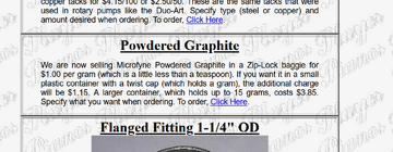

Odie, is their any messiness between application cycles of the graphite? Does it continually come off from hand touching or anything else in contact with the bed?
All I can say is, if a few of you try the graphite, you won't go back to using a paste wax.
