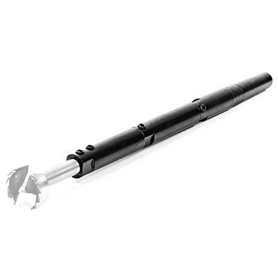

Looking for a simple, minimalist way to attach a forstner bit to M2 tail stock. I have a M2 chuck but it is long and has a much larger diameter than tailstock quill. Opinions and options are welcome. The product is $53.
I just use a drill chuck with an m2 arbor. All types/sizes available. I have a 6” extension to go deeper with a forstner bit, its about 3/8” dia, flares at the end with a hole/socket in the flared end to hold the bit shaft and 2 set screws.
The system you reference would be good for boring deep holes over ~8” (depth I can reach) with the large shaft dia. I use ship auger bits for deep holes, held by a drill chuck mounted in the TS.
I only use deep drilling when making a deep hollow form/vase. The size of the opening desired is determined by the bar size I will use for my hollowing system.
Perhaps a description of what you expect to use this boring bar for would help with more options.
For shallow holes, or ones where the bit is not as big as the chuck, most will use a jacobs chuck, which comes on a #2 morris taper. Not sure if the chucks on our drill presses are the same taper or not. There are a lot of them out there. Some have keys, some are keyless. Not too experienced with the keyless variations. Any turning supply place will have them.
I use the Strongbore system, especially if I'm drilling smaller than my M2 Jacobs and/or deeper than the length of the Forstner bit. I'm happy with it and think it's worth the price.

I tried the product when it was first available. The 2MT appeared to be machined on a lathe and not ground. With just 1 section added, I could forcibly insert it in the MT, a couple of wiggles and it I could pull it back out of the tailstock or headstock taper by hand. CS worked with me and sent another unit that they tried it in all 7 of their lathes. It exhibited the same characteristics. No, it is not a problem with my 3 lathes headstock and tailstock tapers.

The strongbore looks like it would produce more accurately straight deep bores compared to a forstner mounted in a drill bit extension. Useful for salt/peppermills maybe and other turnings that require big deep accurately centered holes. However, for simple boring of hollow forms and bowls, the bit extension is plenty adequate. I've used the bit extension to make peppermills. It works just fine as long as you go slowly with a sharp forstner. I'd only buy it if I were making a lot of peppermills.

Checked your link and the set on Craft Supplies USA is for 3/8" shank bits, which is fine if that is what you want. I have, however, used 1/2" shank bits if I need a hole 1/2" or smaller. The only site online that seems to sell the 1/2" version of the Carter Strongbore system is Carter itself with about $19 shipping to my address. It seems like a good concept though.
