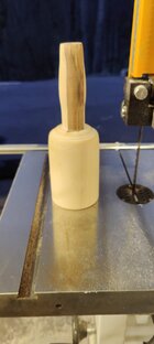

Thank you for the ideas. I had some time after work and tried a no-frills wooden mallet.

I agree this is a great first or even refresher project. Great practice with a skew as well! I made one a while back and never liked the weight for its intended use, so i drilled out the end of the head and glued in a brass disk to weight the head a bit more, now I it is my go to when I need a mallet.

I drilled out my last mallet and filled the end with molten lead, then plugged the end with a contrasting wood. Turned it in to quite the persuader! Works very well with my big carving chisels.
