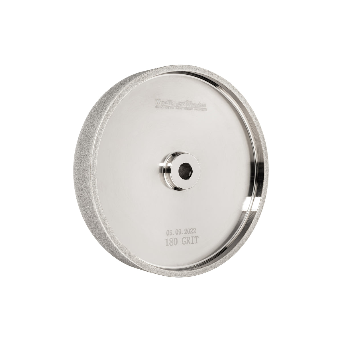

I picked up a 1-1/2-in wide CBN wheel labeled "Hurricane" - I suspect it's made by a company in China supplying other labels (UF-Sharp for example). Its worked well for me at 180 grit as recommended by most folks. I'm trying to get another wheel but cannot find the 1-1/2 width wheels without some form of radius on edge. Rikon (my grinder) sells 1-1/2 8" wide CBNs but they have 1/4" radius effectively making the wheel a 1" wide. Is there a benefit in having this radial edge or even the 4-1 ones sold by WoodturnersWonders and other outfits? If I am sharpening mostly gouges on a platform and vari-grind jig, is there benefits in the rounded edges?

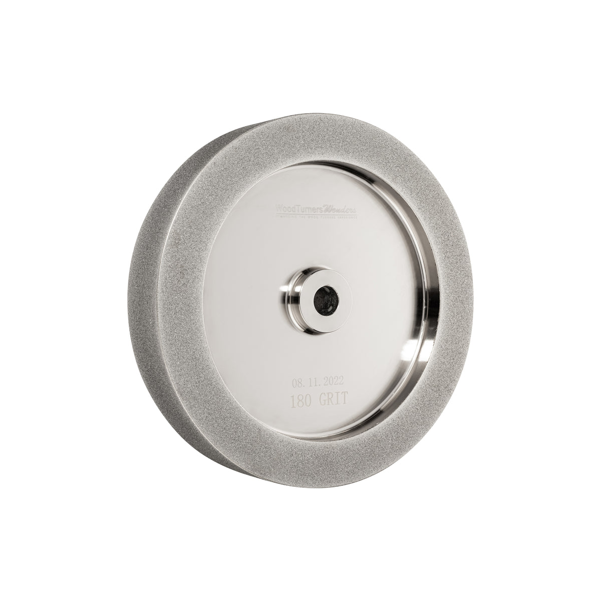

I have this - square and works great
This is a similar wheel from Woodturners Wonders:
1-1/2" wide wheels are available from many sources. Here's another one.
I have a 2" rounded edge wheel and a 2" square edge wheel and I have never found a use for the rounded edge and will never buy another one.
I agree with Don. I too have one square (600 grit) and one round (180 grit), from Woodturners Wonder. I've used the radius edge on a special tool one time.
Wish I'd gone with both square.
They work well for sharpening hollowing tips - push each edge of the tip along the radius edge of the wheel
On my bent tools I sharpen the right edge of the cutter at least 3/8” on the side. Easy to do on a radius wheel. Darn hard on a square wheel
This long edge lets it take a 1/4-3/8” cut during the early hollowing to make a big opening inside.

Raj, plus one for the “mega square” wheels.

Thanks I have probably picked which wheel id get, it would be the mega with straight sides from the woodturners store, ken rizza, I believe. Steep about $200 but i guess a lifetime purchase for a non production turner.
