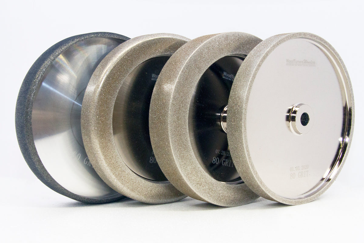

I'm a self taught turner for about 2 years now and have been able to get answers from You Tube but unfortunately sometimes miss the mark. I'm on a fixed income so I have to choose wisely before pulling the trigger. I'm in the market for a 180 grit CBN Wheel and I'm wondering if the less expensive ($99.00) wheels are worth buying compared to the $130.00 wheels. I have an extensive construction background and am very familiar with quality vs cheep junk with tools of the trade. Alot of times a cheap hammer works fine for someone hanging picture frames but would never attempt framing a house with it. The other question is radius corner vs 90 degree. Is there really any advantage to rounded corners? I hardly ever turn green wood and turning is more of a therapeutic hobby more than anything. I don't own any high quality turning tools mostly Harbor Freight with a couple of Hurricane bowl gouges. I've made several scrapers and am noticing I need to sharpen quite often but that just might be because of my lack of experience. I enjoy Spindle turning just as much as bowl turning and have recently discovered an interest in miniatures. Any help is much appreciated.

I use a 180 CBN for all my spindle tools.
The radius edge is great for sharpening hollowing tools. Or other scraper tools where you sharpen the side of the tool on the radius- this can’t be done on the face of the wheel without hitting the motor with the handle.
The radius edge doesn’t work for sharpening spur drives need a square edge for this.

Thanks, I actually have the Spartan 180 in the cart but was wondering if the rounded edge would be worth it for me.
No one NEEDS a CBN wheel, it's just that people want them. On fixed income is a great reason to not buy one. Keeping an aluminum oxide wheel tuned up with a diamond dresser will do the exact same work. We sharpened tools for decades after decades with aluminum oxide. CBN is a very recent addition and it is not a necessity to join the cool kids latest. Actually people turned for centuries without CBN.
People also travelled long distances for centuries without flying.
With CBN wheels you get a computer balanced wheel that never needs to be dressed. For me, that alone is worth the price. Woodturners Wonders has great customer service. With the $99 wheels, who do you call if the balance is off or the cbn wears prematurely? Will they replace it? I think that is the real reason (and value) for the $30 price difference.
I'll give a dissenting view: Given what you have said about your woodturning, I doubt you'd notice any difference between a $99 and $130 wheel. Rounded corners? I don't have them and I've never thought, "Dang, I wish I had rounded corners on this wheel." Now, the dissenting opinion to my own opinion is, "Buy the best and only cry once." It sounds like that isn't an option for you so you may have to kiss a few frogs before you find the prince.

I'd say go for the cheaper option- If you really feel you NEED a CBN - Al Oxide wheels work fine as well if you keep them dressed (It isn't difficult, but does require the dresser and some practice to get it right) Downside to AlOx is they lose radius as you dress them so any jigs you use have to be adjusted every so often - CBN wheel would maintain radius and never need dressing, so you'd not have to re-adjust your jigs either. I'd go for the $99 wheel (I wish they had been available when I was looking to buy one - like you, I am on a tight budget- but I lucked into a used one for sale on here that I grabbed) As for rounded corners, I have had very little use for the feature so far (Though it has been useful for a couple other grinding projects non-turning-tool related) however.... Being a hobby turner, I'd guess it unlikely you'd wear out your cheap CBN wheel before you wore yourself out - The pro turners and guys that work at it every day for hours at a time (and usually are the folks that can afford it anyway) would be the Buy Once-Cry Once crowd (I agree with them for the most part, but I also understand what it is like being on a tight budget - It took me over 3 years of scrimping and saving to afford my new Jet lathe!) But if you can swing the $30 difference between the $99 and the $130 wheels, (Hey 30 bucks is 30 bucks! For some guys it's pocket change, but to you and me, it's a LOT of money!), I'd highly recommend to go for the $130 one. But as I said, if you feel the need, and can't justify the extra 30 bucks, by all means get the cheaper one.
John
I notice no one so far has mentioned this: CBN Wheels typically do not handle plain old carbon steel tools very well - They load up and have to be frequently cleaned so if your cheap tools are not M2 HSS or better, you may wish to stich with your al-ox grinding wheels until you can replace your tools with M2 HSS (like the hurricanes are) Others have said there isn't really a problem with occasionally grinding carbon steel on a CBN wheel, though.. Just thought I'd mention that point.
My thought is what Brian says at the end of his note, and in your situation, I agree with Richard. If you're using Harbor Freight/Craftsman turning tools, you might be better off with a friable aluminum oxide wheel rather than a CBN wheel. If you have limited funds to devote to your tools, the money saved by not buying CBN could go towards something else that will give you more actual benefit. (in general, I'm a big fan of CBN wheels for all the reasons mentioned above. But not for John, at this time)
Except with the aluminum oxide wheel it wears down and if you use a jig you have to keep adjusting it. With the CBN wheel you can leave the arm alone and always get the same grind.
Quite a bit to think of. Appreciate everybody's thoughts and opinions. I think just on the fact that all my tools are regular HSS and if that creates a problem It probably wouldn't be wise at this time. Since I don't see myself replacing all my tools at with high quality m2, I guess I'll just go for that f
4 Jaw Chuck and I was looking at instead. Thanks for all the opinions and advice.
There is no reason not to sharpen HSS with a CBN wheel, that's what they are made for. The difference between CBN and Aluminum Oxide is like night and day. I keep 1 AO wheel to reshape (I have a number of unground gouges so I shouldn't say reshape), but if all my gouges were preground I would not need the AO. With my jig and CBN I probably remove only 2 or 3 thou each time I sharpen so it will take years and years to use up the flute of my gouges, they will outlast me. My first CBN came from Austria if I remember correctly about at least 15 years or more ago. It was close to $300 but that wheel today looks and feels the same as the day I got it (it is my main wheel meaning all my gouges are sharpened on this wheel). I have 5 other CBN wheels on other grinders which were much less expensive (including a 1000 grit CBN on the slo-speed grinder thanks to the generosity of a member here). These other wheels have been available for use or abuse of turners here for hands on classes, they have held up very well. That being said I do not care for the rounded edge CBN wheels, I prefer the sharp cornered ones. Get a CBN you will not regret it.

Looks like I have alot to consider. I know one thing for sure, as much as i'd like nothing more, I'm not going to be replacing my cheap tools anytime soon. For me as a hobby turner, just because it would be better it doesn't mean I should do it. I spent 40+ years chasing the best because I could afford it and time was money so a breakdown on a job site because of a cheap tool was just wasting money. I'm really enjoying this hobby but it's a very expensive hobby so I really need to be careful. I can't afford a 300.00 one way chuck but I'll never waste my money on another Wen chuck. I just purchased a Deefiine 4" chuck for 119.00 and I'm sure a production turner wouldn't waste their time with it but that chuck and my PSI utility chuck will probably outlast me. Just so I understand better, does regular HSS damage CBN or is it safe to use? If I understand correctly, Carbon Steel is not good for CBN. Sorry but my brain don't work like it use to. Thanks to all for your comments I really appreciate it.
Just so I understand better, does regular HSS damage CBN or is it safe to use? If I understand correctly, Carbon Steel is not good for CBN. Thanks to all for your comments I really appreciate it.
Regular HSS is fine for CBN. However, although there is no official grading scale, the tools at the lowest price end of the scale will have the cheapest steel, which means it may not be hardened/tempered to the same uniformity and standards as the more expensive HSS. As Brian says, it should all technically be M2 steel.
If you stick with oxide wheels, you should consider honing. Alan Lacer has an excellent article on honing in Am Woodturner Spring 2003. He has a second article (Lacer and Wright Summer 2009) with lots of photos of sharpened edges. He is mostly comparing the older grinding wheels with hand honing via diamond hone, but also covers power honing . IMHO using a CBN wheel reduces the need for honing
My 180 cbn wheel is 7 years old and cuts like new. Aluminum oxide wheels need constant dressing and get smaller each day. In 7 years I may have used 10 AO wheels. Also you get a finer edge and sharpness in modern steels and you grind away less material each time you sharpen (using cbn). There are great Austrian made cbn wheels if you want to avoid asian ones(Alan Lacer sells them).
