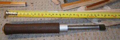

Here is my version of the mark stleger double ended chasers. I mislabeled it 16 tpi and had to restart it. It's 20 tpi. All made with a triangular file, thread pitch gauge and a good magnifier
