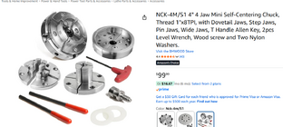

BMWOOD says their jaws are compatible with Super NOVA2, G3 Nova, Robert Sorby Patriot, Record Power SC3, Record Power SC4. Their cheapest option is for 1" x 8 TPI spindles. For whatever reason, they charge 50% more for a 1.25" x 8. If I could get this set in 1.25 x 8, I might be tempted, just for the jaws. FWIW, I can't find any of their chucks in 1.25" x 8 TPI.
