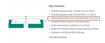

Some manufacturers give an indication of when the Jaws form a perfect circle, like this example from Axminster Tools below.
I used to think that the Jaws were sawn apart but looking at an Axminster Video they were in fact cut apart with a small milling cutter.
The cutter looked to be somewhere between 4mm and 6mm diameter?

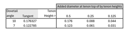

Here is a chart of what you add to the diameter by dovetail angle and tenon height.
For a 1/2” tall tenon you add .176 inches to the diameter to account for a 10 degree dovetail that’s about 11/64 of an inch.
using an 1/8” tall tenon with 7degree ONEWAY jaws you add .031 inched to the diameter of about 1/32 of an inch.
