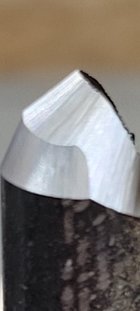

You don’t need to shear scrape. I finish all of my bowls with a sharp bowl gouge and a push cut. Zero tear out and start sanding with 120 to 180 grit. I grind my bowl gouges to 55 degrees and remove the bottom half of the bevel.1000000447.jpeg
You don’t need to shear scrape. I finish all of my bowls with a sharp bowl gouge and a push cut. Zero tear out and start sanding with 120 to 180 grit. I grind my bowl gouges to 55 degrees and remove the bottom half of the bevel.View attachment 62552
You have a steadier hand than I do Rusty. I typically start with a 5/8" 40 degree bowl gouge, then 1/2" 50 degree bowl gouge, then sheer scrape to clean up and sand. If I don't sheer scrape to even out the ripples and bumps then I have to spend too much time sanding. But I take your point and hopefully will gain some skill.
