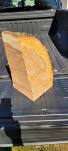

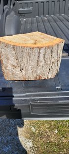

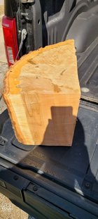

I saw a couple of guys cutting down a tree. I had to stop and ask if they were looking to get rid of some of it. They said somebody already claimed it and it wouldn't be good firewood. I told them I was a woodturner and tried to get a couple of pieces when I see people cutting down a tree. They gave me a couple. They said it was cottonwood. Looked like spalted maple to me. It is spalted. What do you all think.FFE59726-A22C-4693-A766-43D36A45E665.jpegC60468B4-F31A-4B61-AFBC-22EFAC37ACB1.jpeg8B3E4B6B-05F4-417E-84CC-408871F8F46D.jpeg
View attachment 50414View attachment 50415View attachment 50416
Stained Silver Maple IMO, here are 2 pics, Silver Maple and Large Cottonwood tree.Siver Maple tree bark.jpg
Only cottonwood I have seen was in New Mexico, it was large tree
There are several species of Cottonwood in the U.S. Most prevalent are Black Cottonwood and Eastern Cottonwood. I turn a lot of Cottonwood because I can get pick it up along the river almost anytime. It is one of the few "hardwoods" I have easy access to. It is highly unlikely that that is Black Cottonwood, especially if you got it in West Virginia. Black usually has the much courser, thicker bark like that shown in the picture with the kids hugging it. Could be Easten. If so, it'll be pretty soft. Oftentimes smells pretty bad when you turn it. Decays very fast. Also gets wormy quickly. I'm not super fluent in east coast trees. you've got so many to choose from.
I don't disagree with the assessments of this particular piece. For a while I collected cottonwood/poplar bark for making fly rod grips and spent a lot of time looking at it. (The grips were beautiful but brittle, and ultimately didn't work out.) Cottonwood sometimes has large patches of flattened bark on the trunk. I assumed it was from rubbing against a nearby tree, but I've also seen it where there was no nearby tree to explain it.
I have turned a lot of Silver Maple, and have two big ones in my yard. I agree with everyone that says it's Silver Maple. Turns very nicely, but not as hard as sugar maple. We often call it soft maple to differentiate it. It's roughly half way between sugar maple and cottonwood in hardness and weight. Not typically made into lumber. Your piece is definitely not cottonwood. Silver Maple also spalts very nicely. Good score. Get it roughed out soon!
I didn’t think it was cottonwood but thought I would ask. It looked a lot like what they call water maple around here. I have plenty of that so I only got a couple of pieces.
