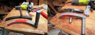

Can't remember, but think I used 5/16 A drill rod. You do have to have it hardened. You can weld it on after hardening without it bothering the tempering, or at least with the test I did, there were no issues, and with the rests I put out, again, no issues. Bending it is not easy, though you may need heat and an anvil if you are doing it by hand. Also, when you tilt the S curve, you will most likely have to flatten the top of the arm. I made a jig and wore out a box of 36 grit sanding belts to do this. An angle grinder might work as well, then file or sanding belt. Not sure if technology is there yet, but 3D printing may make it easier.
When I first made them, I intended them to only be used on the insides of bowls. I found out, and others did too, that they work very well for the outsides of bowls and for hollow forms. Far less moving the banjo and tool rest around when turning forms that have curves.
