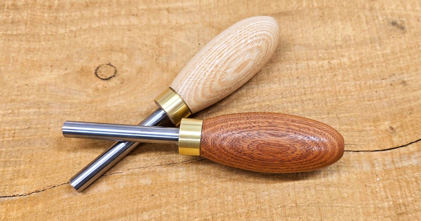

This 5/16" x 6", 92 Rockwell hardness carbide rod showed up at my shop. Bought through Amazon, but it is sold by Taylor Toolworks. (This little rod weighs 4 ounces- it's some hard, dense steel.)
See that little dark line half way down the length? That's the result of one minute of using a standard Dremel cutoff wheel on it. All it did was polish the surface, can't even feel it with a fingernail.
Anyway, I thought I would cut it in half, make 2 handles to mount them in, and I'd have two scraper burnishers for the price of one. (Lee Valley/Veritas already makes exactly what I'm trying to accomplish...)
Will a diamond Dremel cutoff wheel cut through this solid carbide?
If it's more trouble to cut it than it's worth, I'll just mount this rod about 2" deep into a handle and call it a day. Thanks.
Yes, but you may go through a few Dremel diamond cut off wheels before you can cleanly snap apart. A continuous rim (not notched) diamond wheel (typically used for tile cutting) mounted on an angle grinder will do the job quicker. Most hardware shops sell those diamond discs. For a neat job mount the carbide rod in your lathe chuck and use the toolrest on the lathe to control the feed rate of the cut.

Well, that was fun. The little diamond cutoff wheel was working- very slowly. So I put a fresh 4" general purpose cutoff wheel in my angle grinder and went at it. After several minutes, it made the groove shown as the dark, smooth patches on each stick. Did the same for just a minute or two from the other side. Then holding in my bench vise, I put a steel cheater pipe over it, the fulcrum point right at the cut groove, and they snapped right apart. I then lightly dressed off and sharp edges on the cbn bench grinder wheel. Now I'll make a couple handles and I'll be in business.
Moral of the story- buy carbide rod in a length that will work for your project without needing to be cut to size.

Sometimes I'm just a lazy procrastinator. Tossing around the shop since February, glued but otherwise unrefined and unfinished, are my two carbide rod burnishers. Today I finally made them pretty. 6.75" long total (5" handle incl. ferrule), max. diameter 15/16" (arbitrary, but they feel good in the hand), figured maple handles with copper pipe ferrules, Tried and True finish. The 5/16" carbide extends 1.75" from the handle. The ugly cut end of the carbide is inside the handle. I'll keep one at each lathe. @Dean Center has a better carbide rod version in his message above- no cutting required.
I think most of the time when cutting carbide, you cut part way through, put it in a vice, and then with a towel over it to prevent shrapnel from flying into your hands, and then snap it in half. Years ago, I bought 100 carbide rods that were 3/16 diameter. Can't remember.... They were perfect size for burnishers. My first one was a carbide drill bit, and others have used old router bits. I do like smaller diameter rather than larger. When I first started burnishing burrs on my tools, which were all M2 at that time, I had some mini carbide bits that I drilled into a steel handle. It worked fine. A standard triangle burnisher for card scrapers did work on M2, but with the round rod, it was difficult to say the least. With M42 or V10, you need carbide. I would expect that carbide will burnisher that StewMac scraper that some use, and they don't tell you what kind of metal it is....
