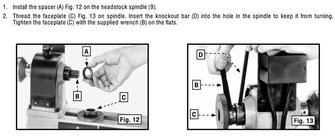

I guess I was not clear in my answer, so the mis-understanding, I also never use a nylon/plastic spacer, what I was referring to is a precision metal spacer that came with the Delta Lathe, see below in the picture, some faceplates and chucks are not able to fit all the way onto the spindle, that is why Delta included this metal spacer with their lathe.
It is imperative that the two surfaces fit right up against each other, anything small between the two will cause a runout.

The metal spacer will help prevent the threaded insert of the chuck from locking onto the spindle thread. The morse taper and the spindle thread would be the critical component that you should be measuring for alignment. The machined surface that the spacer sits against on the spindle is a surface you could measure for runout to see if the spindle is bent.

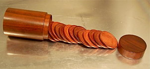

Couple of pieces that were turned by me more than 56 years ago while still living in The Netherlands.
Afcelia coasters and  exotick wood box.jpg Teak and SS taped shaft.jpg Teak & Padoak foot and dish.jpg
