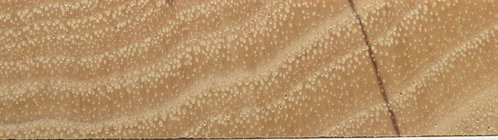

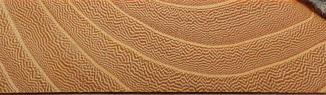

As someone had ID'd a bowl as Pecan, and it is quite obvious that it is Elm wood, I am going to bring the differences up here, the nice thing about Elm wood is that the grain can show you clearly that you have Elm, a bit harder to do with Pecan, as some Hickories are often classed as Pecan.
So first 2 pictures of close up end grain of Elm and Pecan, where the zigzag of the interlocking grain of the Elm wood is clearly showing.
This is Elm wood grain.
And this is Pecan end grain.

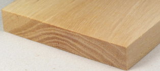

Here is a Pecan board that shows the regular grain of Pecan,
