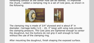

Chip, this has been discussed several times in the past. Here is another option for Cole or Jumbo Jaws.
