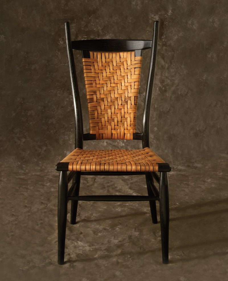

Perhaps the best advice I've found for this sort of ebonizing is from Brian Boggs
I found that the quebracho he recommended for increasing tannin worked well, at least on some woods. This ebonizing is very much a coloring which sits on the surface, so sanding can easily remove it. On ash, it would remain in the coarse grain but barely take hold on the smooth close-grain between the rings. I've been happy with the results on relatively few woods. I can't comment on walnut since I don't use it at all since I react to it.
