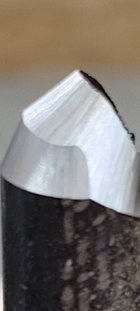

My main go-to gouges are a 1/2" Benjamin's Best and P&N 5/8" both using an Ellsworth jig to sharpen. The Benjamin's seems to accept the parabolic Flute using the stock instructions a little better.

I mostly use an Ellsworth grind on the Jamieson gouge, 3/8 spindle gouge.
I’ve turned hundreds of bowls (1000?), the significant majority of them being glued up blanks of kiln dried wood. When turning green I’m almost always just first turning blanks to dry so really only use a 5/8” bar parabolic flute and watch the ribbons fly :)
Turning glued up kiln dried blanks my favorite gouge is also the 5/8” bar parabolic flute, ground on 600grit cbn using a wolverine jig. I’ve never really studied grinds but use a semi-swept back wing, a little convex and ~3/4” wing on the 5/8” gouge. For whatever reason I sharpen the 5/8” with the nose angle of 55deg, my 1/2” bar with 50deg angle, my 3/8” bar bowl gouge at 45deg angle; all of my spindle gouges are set at 35deg. Recently I purchased a 5/8” Robust parabolic bowl gouge that I need to sharpen at 60deg to get reasonable performance from? I could probably benefit by spending time experimenting with grinds, but I have more fun turning :)

I had a P&N bowl gouge and could never get an Ellsworth or satisfactory swept back grind on it. I think they have a U shaped flute, which is known to be incompatible. I converted it to a Bottom of the Bowl gouge, and it works very nicely for that.
I'm going to look into this. I believe you are correct about the U shaped Flute.
