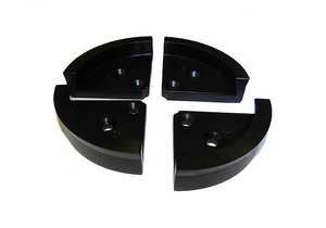

The serrated tower jaws have no gap. 7F3224AC-8018-4234-B168-45B04075D763.jpeg

According to that, the gap is even larger. However, the specs I gave are accurate, and measured from my own serrated jaws. What I wonder, is if the difference between the kind of jaws used may be different, and the same serrated Stronghold jaws may have changed dimensions over the years.....?
Anyway, it's a moot point, because I'd like to have the option of making tenons within the unusable gap that these Stronghold jaws don't cover. If this has been addressed over the years, that would be a solution. If there is another full sized chuck that's currently available, I'd be interested in knowing which ones do cover the aforementioned gap.

That 3" dovetail has been missing across all manufacturers for some reason. Vicmarc custom-made the 3" for a while but for their vm100 chuck and jawline. I know this because all my jaws fit my vm120/vm150. I was contemplating the purchase of the chuck to own this size, but I ended up custom-turning 3" dovetail jaws out of UHMW on Axminsters flat jaws. Oneway has flat jaws that enable you to custom make your own size jaws as well. This may be a solution for you as well.
Got to wonder why so many manufacturers have these gaps. My old Nova set is the same way. Then I bought a Nova Infinity chuck from an acquaintance in the woodturning club then bought the remaining jaws to make a full set. These are sized in a logical manner and have a decent overlap from one jaw set to the next. They get used constantly.
I have the same issue with my Stronghold jaws, but generally fill that gap using a Record Power SC4 with 100 mm Deep Gripper jaws. Might not be what you're looking for - it's a dovetail at the top, with serrations below to grab a longer tenon, but it gives me a solid grip in that 3 - 3 3/4" range.
