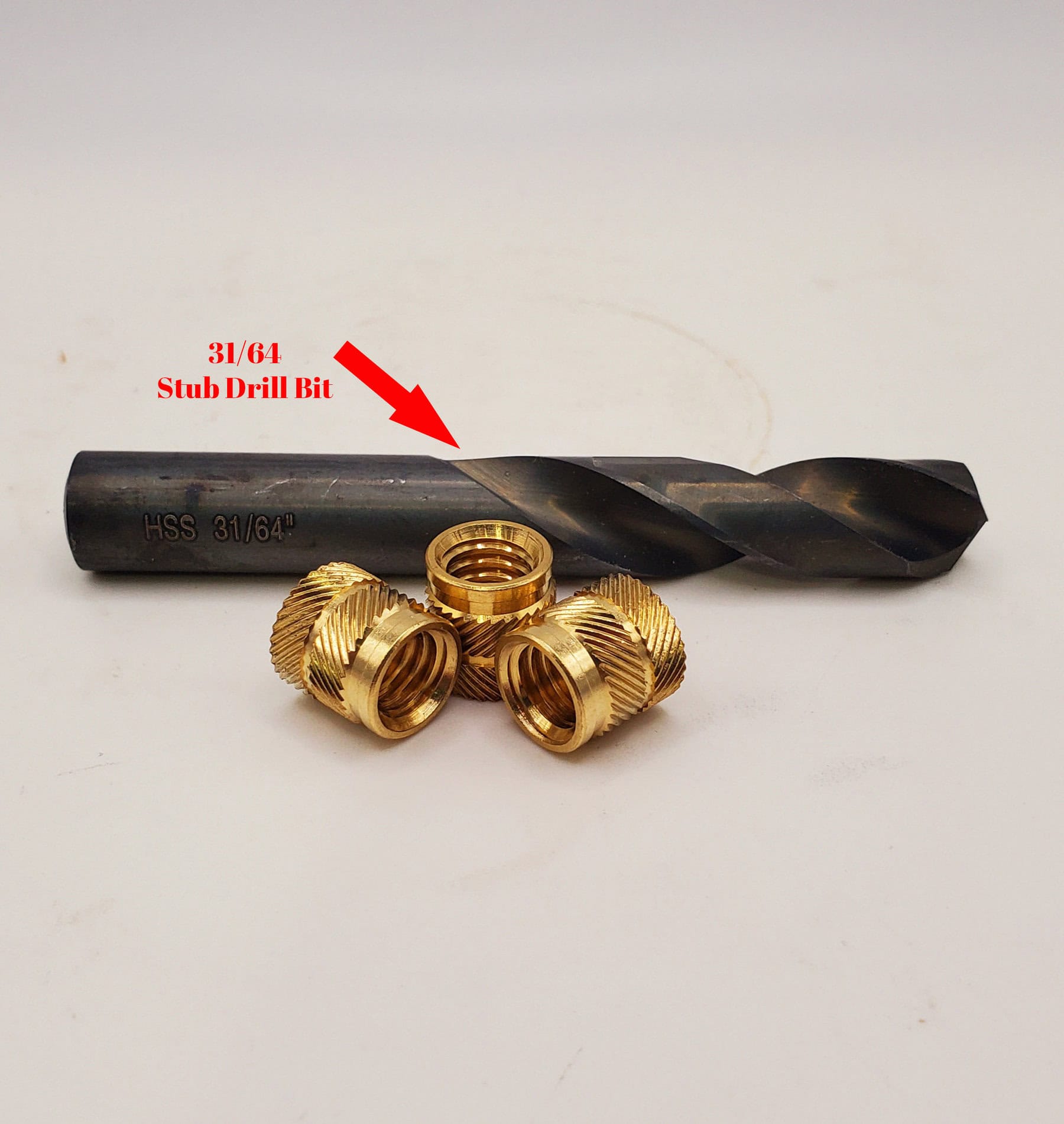

In that case, what about threading it? If the wood is hard and fine grained (ebony, cocobolo, dogwood, hard maple, etc) and relatively mall diameter tenon and hole, you can use standard taps and dies to thread both parts. Further harden with thing CA if needed, and re-tap. A bit of wax on the threads can make these easy to screw in and unscrew.
Another option, is a threaded brass insert in the lid and either threads on the finial or a section of brass bolt permanently mounted in the finial, hole drilled first in the end to hold the glass rod. I imagine that would be a first class solution! - very easy to remove and replace. If you don’t have a good way to drill a hole into the end of the bolt, many woodturners have machining capabilities that make this trivial, probably some close to you.
I use brass or SS inserts from Ruth Niles Stoppers (or from the hardware store) for a variety of things that need be taken apart often, say for cleaning, like meat tenderizers with wooden handles. The inserts can be glued into the lid and the threaded rod can be screwed and glued into threads tapped into the end of the finial. (I’d still turn a shoulder on the finial.)
The threads on these are a standard 3/8”x16 which may be fine if your glass rod isn’t too large in diameter, but larger inserts are available elsewhere.
