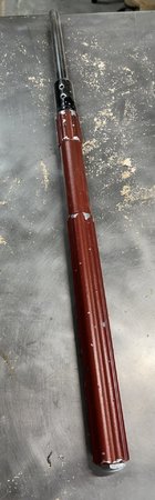

Picked up a Glaser gouge yesterday. I'll try it first, but I am pretty sure I'm going to want to remove the shot from the handle. There's a plug in the bottom but it doesn't look easy to pry out, and I don't want to mess it up trying a bunch of things... What's the recommended method?
View attachment 54477View attachment 54478
Don’t know if this is “recommended” but it worked for us.
Put the handle in a vice, put vice grips on the gouge, heat the gouge with a torch near the handle, twist and lift with the vice grips.
When the handle cools, dump the shot out of the hole where the gouge was.
Use thick CA to glue the gouge back in place.

I test-drove my new (to me) gouge yesterday, with the shot in it. Roughed out a bowl and turned a hollow form.
I discovered a few things.
First thing is it's really noticeable how heavy the gouge is when taking it on/off the tool rack - yow.
But the weight didn't bother me while I was turning. This surprised me, I expected to feel it. I think it's because the tool is supported on the tool rest and my body/hip, not my arms.
I didn't really notice any advantage to the extra "ballast". Like robo mentioned, if you're having vibration problems, the tool's weight is unlikely the issue.
All that above I could deal with, and if that were all, I might not bother removing the shot... But
The weighted handle makes the tool really awkward (difficult even) to sharpen. I am used to parabolic flutes, so the added weight is making it that much harder to "find the zone" for sharpening this one.

@Dave Landers I picked up a Glasser Hitec at an estate sale similar to the original. I also found it was difficult to sharpen. I un-guled the gouge with heat, added a plug at that end to keep the shot trapped and added two set screws. Since yours is the original, you may not want to modify it, but now I can sharpen my gouge much easier. The Gasser Hitec does have a removable plug at the end.

Well I removed the tool bar from the handle (heat to release the glue) and found that the handle is not bored all the way thru - bored from each end with a 'wall' in between. So no shot came out that way.
Tried to pry out the plug, but I found out later its glued in. Drilled it out and removed the shot. Was a bit over 13 oz (0.82 lb or around 370g).
Decided to go ahead and drill/tap for a couple set screws.
I assumed it was an "original" because of the hex handle vs the fluted shape of the hitec's. But I'm sure there've been several different iterations over the years. Doesn't really matter - I bought it mainly for the steel (and to use vs look at). And now I have a nice bit of tool steel plus a nice handle I can mix n match with other 5/8" tools.

So quite an adventure. I didn’t expect yours would be different.
We have
2 black handled 5/8/dia gouges no wall inside and
a red handled 3/8 dia gouge that has set screws and no shot.
Sorry to mislead you.
