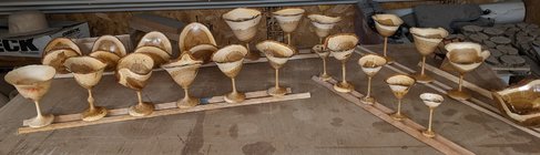

This is a technique that I was initially introduced to at a Demo by Del Stubs in about 1990 and I am guessing that I have turned well over 1000 goblet forms ranging in size from about 2" tall by 1 1/2" diameter to 18" tall by 10" diameter. The goblets are turned from the full round of a tree trunk or branch and it is best using fresh cut live trees cut in the dormant stage, which is the best way to guarantee that the bark will stay on. The reference to shear scraping is as it was at the time, which I still believe is the best and most efficient way to get a smooth finish on green wood. The picture below will show how out of practice I am in this case the wood is an upper branch of an Iron Wood or American Hornbeam cut down on Sunday the 4th of April. The problem is the heart wood is very dry and darker than the sap wood so very little light came through at the transition so when I got down to about 10thou" it fell off as shown. The 3rd one has a knot that caused a problem. The 4th one I sprayed water plus stopped regularly the measure the thickness so I knew what the light getting through meant.
The photo below is the first one when things were going according to plan, the thickness at the bark is about 60thou" and down to 20thou"at about 1/8" before the point of separation.
Thanks for the interest and if you have any specific questions I would be glad to try to answer.
