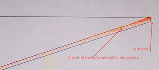

Of course we have heard all of this before of sharpening the tools with a different wheel or other ways, and it is then claimed to remove less steel.
So my take on this is no matter what you use, fast or slow any color wheel etc, you do need to remove all the steel to get that sharp edge again.
A picture here that is supposed to show a blunt nose on a tool, and the line to where the steel has to be removed for the edge to be sharp again.
The orange colored part is the steel that has to be removed to get that sharp edge again/
7,113
9,741
Great illustration Leo......
This brings up my belief that when overheating occurs, the very tip might have been 1500°, while the rest of the steel was not nearly that hot.....therefore not losing it's temper anywhere else. At the very tip of the edge, the thicknessof the effected steel may be .0001" thick, and does not have the ability to distribute the heat like where it is thicker. Therefore, the ability to hold the edge has been lost. The steel is still ok, it just needs to be re-sharpened. After you get the bluing at the very edge, if you use it that way, it will dull faster......if you just cool the steel and re-sharpen without getting any bluing, all will be ok.

Ridiculous, I'll bet that I'm taking .010 or less off the tool to resharpen. My cutting edge to the first secondary bevel is about a 1/64" and after 4 sharpening it may get to be 1/32". I then hit the secondary bevel again to get the bevel back to that 1/64". You know that tool that you feel is dull would still slice through your skin and leave you very open to stitches.
12,896
5,181
This brings up my belief that when overheating occurs, the very tip might have been 1500°, while the rest of the steel was not nearly that hot.....therefore not losing it's temper anywhere else. At the very tip of the edge, the thickness of the affected steel may be .0001" thick and does not have the ability to distribute the heat like where it is thicker.
You have made a very good observation. Compared to most other common metals, steel is a relatively poor conductor of heat. And, we need to make a distinction between "heat" and "temperature". Heat is the transfer of thermal energy measured in Joules. When you grind the bevel of a tool, thermal energy is transferred essentially uniformly to the bevel, but because the incremental volume of steel is less at the edge than it is at the heel of the bevel, the temperature at the cutting edge will be significantly greater. How much greater? The oxidation color of the steel is a pretty good gauge. For dark blue color, the temperature is about 600° F. Here is a picture I found on Wikipedia that shows the colors that are the result of various tempering temperatures.
If you consistently blued the cutting edge it probably has a small effect o the hardness of the cutting edge. For high carbon tool steel, we know it's bad news for edge durability. But, high speed steel is designed for fast machining of steel with resulting high temperatures even with coolant being sprayed on the cutter. So, my guess is that a little blueing is OK, but I still avoid getting the cutting edge hot enough to cause bluing. I just feel like using a light touch I can get a sharper edge.
