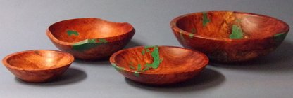

Don, I've only tried Milliput epoxy putty a few times. Worked OK but very limited colors and hard to mix other coloring with it well. Are there others you've used? Like you said, the attraction is that it stays in place while working with it. You can also work and smooth with damp tools and sands well.
I have never tried to color it and I don't know of any brand that comes in colors. When I use it to fill large voids after it is set I up I sand or cut it flush with the surrounding wood then I under cut with a Dremel tool about 1/16" deep and fill with powered mineral usually turquoise and thin CA. The 4 mesquite burl bowls were all done that way including the second from the left where the weird edge that was caused by how the blank was cut and there was no wood on that corner.
