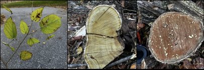

Hey! I’m in western NC cleaning up and cutting blanks from a huge hickory that blew over this summer. This small tree was collateral damage.
The freshly cut wood in the center photo is very yellow, but I just could not get it to photograph.
Edit: I added the bark pic. Pretty sure now it is mulberry. Thanks all!

To me, the yellow colored wood looks more like mulberry. Hackberry around here is white until you let it sit for a year;). Hackberry is also a relatively soft wood, while mulberry is much harder. Look up a picture of hackberry bark, it is very distinctive in appearance.
I don't find hackberry to be soft at all. Along the line of ash for hardness around here. Hackberry usually has a core color of nearly black color. As hackberry gets bigger, the bark looks like bumps and warts. Which wood do the leaves belong to? Definitely not mulberry leaves. The color of your picture reminds me more of black locust or redbud. The two cream/dark vessels on the left are hackberry. This log had a very unusual core.

That is mulberry, for sure. The leaves, color, and visible bark in the second pic confirm.
If it was hackberry, it would likely already be spalting, or at least fairly grey/blue already. Hackberry (and Sugarberry) are some of the most aggressive spalters that I’m aware of.
