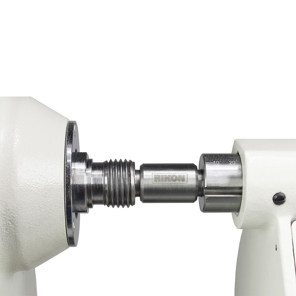

Get a double end Morse taper alignment tool. There are a lot of them on Amazon, but not sure about the accuracy. Here is a link to one made by Rikon.
I have two and they work if you're more than 1/4" out of alignment...not so much if your less than 1/8"
