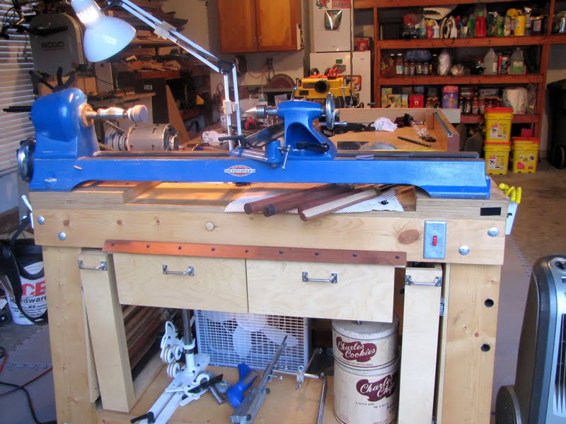

Sounds like a latrine rumor second class, as we used to call them. Might want to question the time frame, as Bill suggests.
I wouldn't get a stand if I had tools to build one. Building one allows you to make good use of the space underneath that's wasted on a stand. Cabinet out of heavy sheetgoods with a double top is what I'm using for my 3000. Just mount the lathe all the way up front, so you won't have to lean, and extend the legs about 4-6" at an angle to counter over-the-top thrust. Think of trapezoid ends, with the rear at 90 degrees, the front at perhaps 10 off. All the mass required to hold the lathe stable is supplied by the cabinet. Put your heavy stored items on the bottom to keep the CG low.
Elevate your lathe ends above the table on 3/4 or a pair of 3/4 blocks so you can clean out underneath and give that motor some clearance.

As the Mouse recommends, build a stand. Something like he showed, or something like this:
