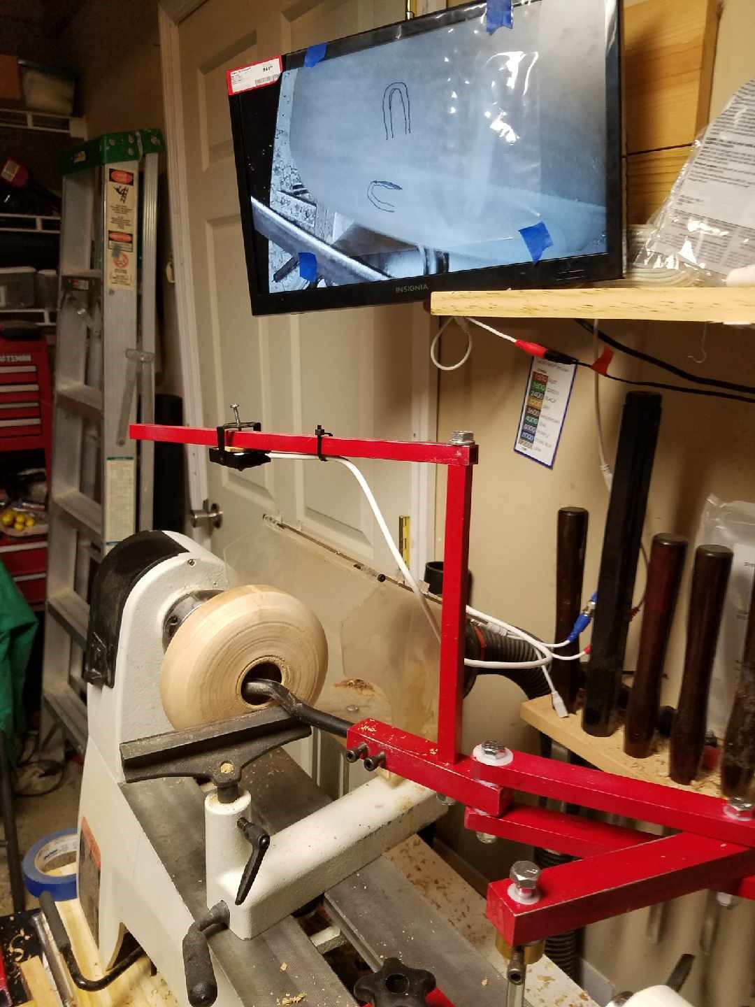

Hey guys,
i have a short bed on my midi 46-460, most hollowing systems require much longer bed. I am looking into the Elbo with the extension they offer as well as Bosch's stabilizer since it doesn't require additional stand, any recommendation?
Here is one that I made last week for under $100. Camera, tv, and all articulating arm parts. I'm sure that it will fit any lathe, even my 1221.
And that is my 1st ever hollow form.
Regis
