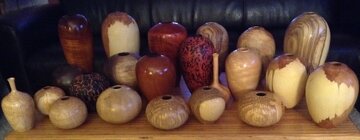

Maggie, I own both and mainly turn hollow vessels, some fairly deep around 400mm. The Rolly Munro works really well within its limits, ie He recommends .25mm cut and generally a bit lower on the speed than you would normally think. How slow? Well, much depends on the species you are turning, and I turn mainly Australian hardwood. So for me its under 1000rpm and often down at 5-600. I use it as a finishing tool and or small pieces like my avatar, this piece was around 100x100 or 4x4" in Solomon Island Queen Ebony. I find for small pieces its ideal as it has a small head compared to the Pro-Forme. The shaft at 16mm matches the head well and the handle is comfortable and long.
