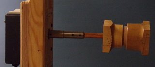

I have been spraying BL for over 20 years starting out with an air brush then moving to a gravity feed cheapo spray gun and when doing round pieces that don't lend themselves to the systematic spray pattern that you would use say when painting a car, I use an off lathe rotator and spray on an extra heave coat of BL that of course would run if it was not rotating.101_1231.JPG
This rotator is made using a rotisserie drive mounted to a stand with an adaptor that will accept a 1/2" dowel. The fixture on there is a male thread that is used to screw on a threaded hollow vessel and the piece that is screwed on is the female thread to accept the lid. This method allows a much faster build up and is easier to avoid orange peal and runs.
Oh that’s a nice setup Don! I like the idea of having an off-lathe apparatus for that. Frees up the lathe. I hadn’t thought of a rotisserie motor, but it seems like the perfect speed.

I have been spraying BL for over 20 years starting out with an air brush then moving to a gravity feed cheapo spray gun and when doing round pieces that don't lend themselves to the systematic spray pattern that you would use say when painting a car, I use an off lathe rotator and spray on an extra heave coat of BL that of course would run if it was not rotating.View attachment 47530
It is almost too slow but one advantage is that you can start it then spray an even coat without stopping for each pass with the spray gun. I have some others with faster motors ( not rotisserie) that I have to stop for each pass of the spray gun.
