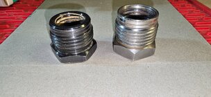

I have two chuck inserts that i am not sure which chuck they fit.
Does anyone have an internal thread list of brands?
Or any easier way to ID than removing inserts from chucks and comparing?
FYI one is 1x8, other is 1-1/4 x8.
Thanks
EDIT: Looking at the various Websites (OneWay, Nova, Vicmarc) I am leaning towards them being Nova inserts.

Inserts from Teknatool that fit Nova chucks should have a code stamped on one of the hex flats. Mine are ILNS, 1-1/4x8tpi to fit my lathes.
I think the external thread that fits the Nova chucks is M38x3.

They look just like my Nova inserts.

CONFIRMED, they are Nova Inserts. First, thanks everyone for the comments and help.
I found an unopened SN2 box with a factory Nova Insert to use as control samples. The brand new insert has 2 markings. A stamped "L" and "Printed Nova L" on the side.
The 2 old ones have stamped "L" (on the 1-1/4") & "T" (on the 1"). I assume these refer to the stock numbers ILNS & ITNS. (Stock !TNS is the 1x8 RH & LH Dual Threaded)
Both old ones screwed into the SN2 as they should.
