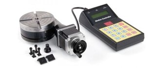

For indexing here's a ready made system.
At it's price around $900 it may be a budget buster. But the same system can be put together closer to $300 by building it yourself with an arduino processor.
