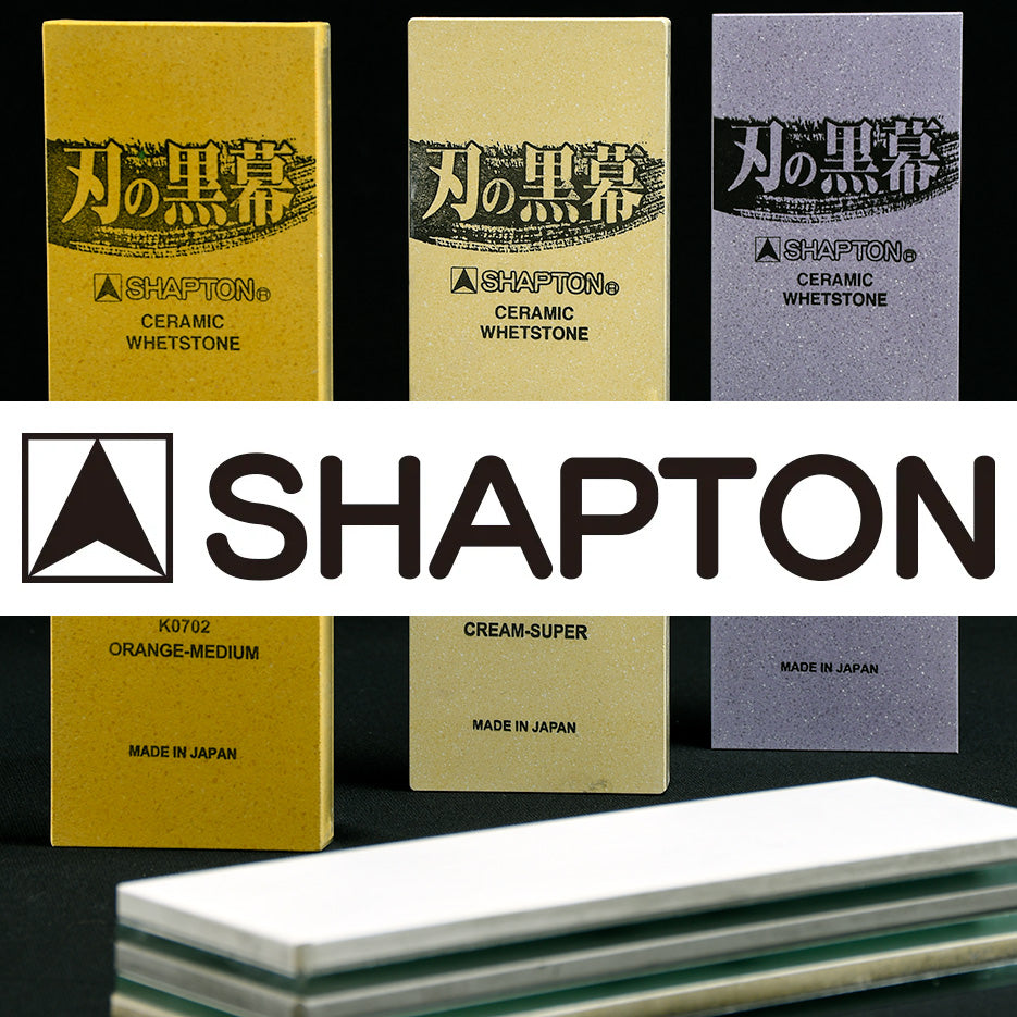

Robo, take a look at the Shapton stones. They require only a spritz of water from a spray bottle.
Also, Tim, I want to mention that going CBN does not preclude using Tormek jigs and that Tormek and Wolverine jigs can be mounted on the same grinder.
I shouldn't have looked! I will have to give them a call. I guess any good supply place will raise more questions about what I am trying to do, and they have a lot of stuff! Worth looking at.
Mark - I overlooked your comment that Reed quoted. Sorry. Yep, I actually have a couple of the "bases" that I can mount adjacent to the Wolverine bases. Part# BGM-100

I shouldn't have looked! I will have to give them a call. I guess any good supply place will raise more questions about what I am trying to do, and they have a lot of stuff! Worth looking .
The Shapton ceramic stones I have are the professional series.
I really like that all you need to use them is a spray bottle of water. So instead of a sharpening pond I have a sharpening puddle: A baking sheet with four raised sides and a plastic cover. It doubles as a storage container.
It's so easy that it is very hard to make an excuse not to sharpen. Although I must say, my excuse making abilities (and I don't mean to brag here) are superlative.
I love my Shapton professional stones, too. I've tried a lot of different sharpening systems, but really like the feel of the Shapton stones, over oil stones or other ways.
