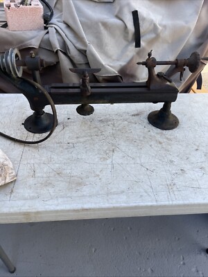

I was browsing eBay and ran across this lathe. It's listed as a metal lathe, but everything about it says to me that it's a wood lathe. Am I wrong?
Any guesses as to the age?

Well, it's made of metal, so it's a metal lathe? Looks to me like a patternmaker lathe without cross slide...
This lathe is roughly similar to one I had about 62 years ago. I wanted to build a cobbler"s bench type of coffee table for the family room of my new house. The design that I liked required two turned pedestals to connect the base to the table top. I looked around and found an ad on the back cover of a popular mechanics magazine for a small lathe for $12.98 plus shipping. I ordered it and bought a1/4 HP motor for about $20, and a set of craftsman turning tools. I assembled the system, laminated some pine 2x4's and turned two 16H x 7D pedestals for the table.
The lathe sat unused for about 32 years until I retired and moved to a new house in Oregon. After a couple of years I became bored and hauled out the old lathe and began playing with it again. I made several small items and got hooked. This led to a succession of larger lathes ending with a Oneway 2432.
t’s a tiny bench top wood turning lathe. Goodell Pratt made little “parlor” sized machines. Like treadle lathes, and treadle scroll saws. There wasn’t much of a DIY industry in those days, people didn’t have spare time. I have the treadle version of that machine, and also the scroll saw attachment. Of course hat is not the original pulley, they usually used a leather belt.

Goodwill Pratt called it an “Amature Bench Lathe” and simply a “Bench Lathe.” The headstock could be had as a “polishing head.” Accessories like a scroll chuck and a sliding tool rest were available. A jeweler’s lathe would be a more accurate and less robust lathe than this. An antique jeweler’s lathe of the same period would likely have only one mounting foot to the bench.
