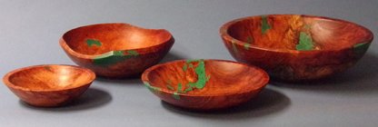

Fill the void with epoxy putty, turn it to the same contour as the adjoining wood then undercut no more then 1/16" and refill with powered mineral such as turquoise and thin CA. The putty takes the most time time to set but it can be molded to rebuild a contour and does not require dams to keep it in place while it sets. The piece must be positioned such that the powdered mineral won't fall off but the CA will set much quicker then epoxy and the fill can be in several quick steps.
B5185_88.JPG The bowls in the picture are mesquite burl and some of the voids as you can see were on the edges.
