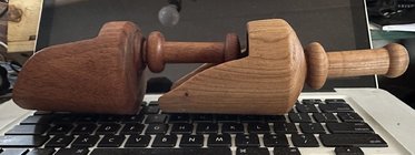

Should do most of what you want to do
A good example of its limitations.
It would not work well for the scoop with the off center handle
I did the offset handle (two axis) scoop with a Rikon 12” 3/4hp lathe. It shook a bit but handled it. That lathe and this Jet have similar specs and weights so I’m assuming it will be able to do it also.

you understand quite well that jet 1220 will not work well for the off center handle.
Can it do it - yes. Will it be enjoyable- no.
Every machine has its limits. It becomes more difficult, uncomfortable, and a bit less safe as you approach those limits.
I’ve worked at the limits of every lathe I’ve had but it’s been an occasional one of sort of adventure.
